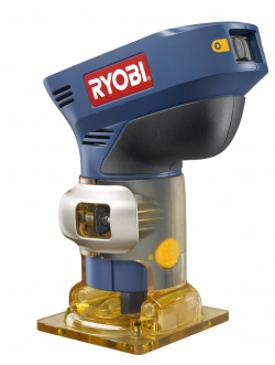

Doe's anyone else have or use one of these. I do and its a great tool with plenty of power 18volts. Bought it at the local Home Depot oop's I mean BORG. Great for binding with no cord to get in your way.
